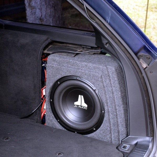

    Hei,
    På jakt etter en knall go 10" element som ikke er stor i montertings størrelse pga den skal i en "fabrikk kasse" på 15L / BMW E39 Touring!
    https://www.transmedia.no/products/b...ring-basskasse
    Kassen er kjøpt inn! Monterings dybbe er maks : 130mm !

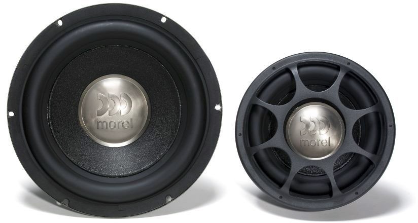

    Har du vurdert Morel? Hva er budsjettet ditt totalt? Evt. for bare subwooferen.
    Trolig en av de mest vellydende i sin klasse:
    https://www.elutstyr.no/morel-primo-104.html
    Denne er 12.4 cm dyp.

      Kjenner til Morel, men ikke lyttet noe særlig til dem.

        Kenny Kristensen vant, som eneste nordmann sin klasse i EMMA EM-finalene i Salzburg med høyttalere og subwoofer fra Morel:
        https://www.bilstereoforumet.no/arti...lass-til-norge
        Her er en omtale av 8"-versjonen:
        http://i.nextmedia.com.au/avhub/inca...fer-review.pdf
        Her er omtaler fra 10 fornøyde kunder:
        https://www.amazon.com/Morel-Primo-1...ews/B00852XSUY
        https://www.crutchfield.com/S-cLXHZV...Primo-104.html
        Over the last 30 years, I've owned a lot of subs(as car audio is one of my hobbies). I dont know why this sub sounds soooo good, is it the paper cone? My last sub was a 10W3v3. Before that was a Boston G3. And before that I had a Boston Pro 10.5. As you can see, I like to spend $200.~ $300. on my sub. Almost always a single 10". This Primo sub is far better than any of my past subs. It's faster, tighter, punchy and blends well with the front stage. The Boston G3 played a touch lower, but it was in a different car, and ported. I have not heard the Morel Primo in a ported box, but if the spec sheet is any indication, It will play flat down to 35 hz, losing only 3 db at 30 hz. I cant say enough about the extreme sound quality of the sub. The downside is it needs a 1 qft box sealed, the upside, it only needs 1.1 qft for a ported box(3" x 11.6" port).

            Hei, står forsatt stille på fronten..Den Morel , kikker mere på nå..
            Helix lar seg ikke skaffe, utgått.
            ser i følge manualen : 20-30liter /Optimal performance at 28 Lit (1.0 cu.ft) !
            Men kassa mi er 15 Liter..

              Primo 10" skal ifølge manualen fungere fint på lukkede kasser mellom 20-34, hvor 31 liter er optimalt. Så så mye nærmere enn det er det ikke sikkert du kommer. Du kan putte litt dempevatt inn i kassen for å "lure" elementent til å tro at kassen er større. Jeg vil tro at om du sjekke spesifikasjonene til den JL-subben så er den heller ikke oppgitt til å spille optimalt på 15 liter lukket kasse..
